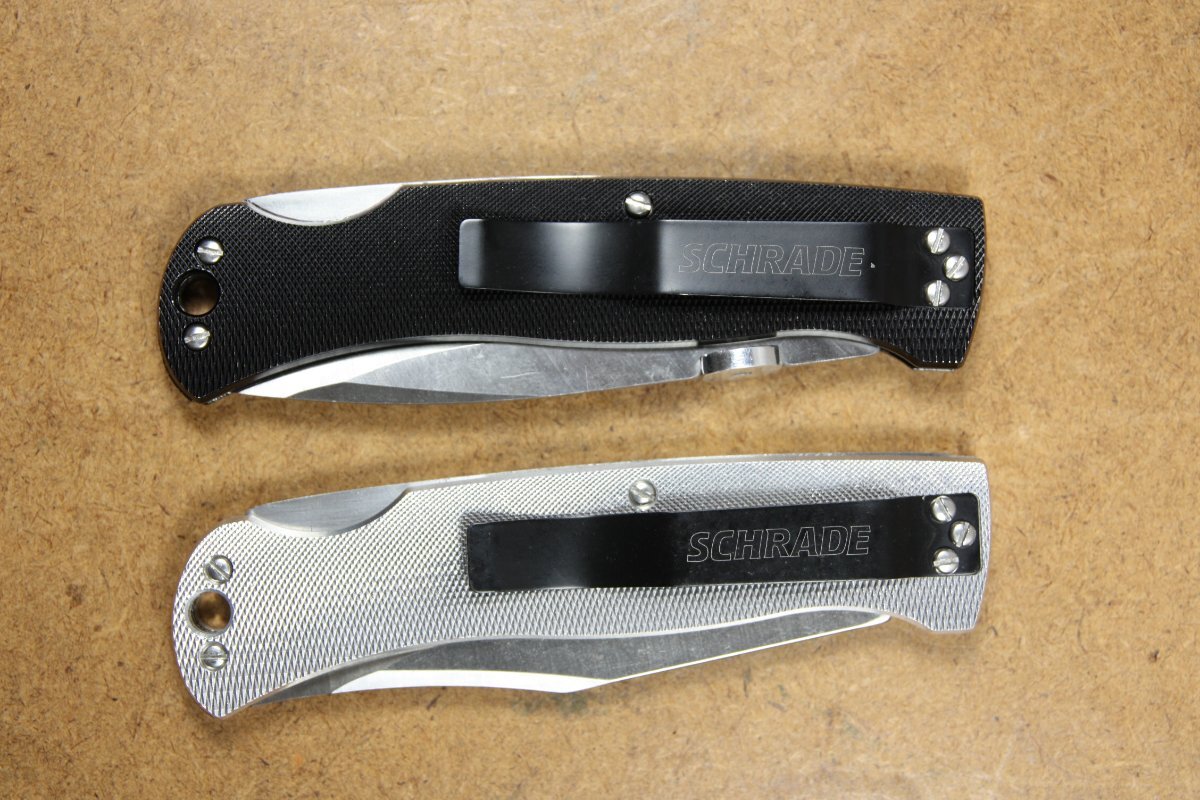

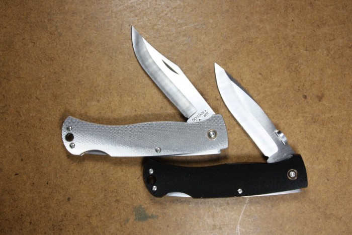

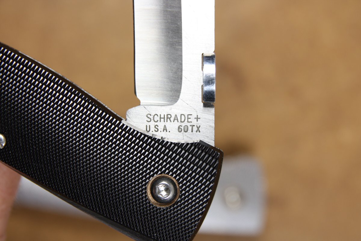

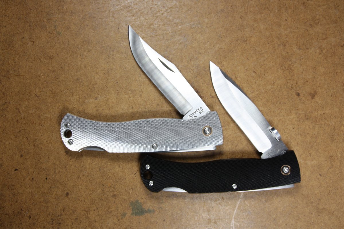

No doubt since Schrade closed their doors more than 20 years ago, there have been countless thousands of knives assembled from the parts that were sold off at auction. I obtained a box of those parts from a friend a while back, and among the items in the box were two sets of handles for the Schrade 6 OTX, one aluminum color and one black, the 6 OTXB. After some work locating the additional pieces needed, I was finally able to assemble 2 knives from parts. Are they authentic to the Schrade originals? No. Are they useful knives for EDC ? Of course. I located original pocket clips online, obtained a 6 OT blade and lockbar from Dale ( orvet), a 6 OTX blade, lockbar, and springs from Kaleb ( muskratman), and screws from online sources. These are really neat, light weight pocket clip knives with the same blade size as the much heavier 6 OT, 7 OT, LB7, LB8 and so on. The 6 OTX blade is somewhat different than the ordinary 6 OT in that it is a drop point with a built in thumb flipper. Since there was no flipper on the blade, I made one from aluminum and press fitted it to the blade.

They look like brand new Schrade USA knives to me. You have done a fine job of gathering the parts and assembling them.

Cal, it was for the most part. The original pins and screws of the correct length were not available, so I found some online that were slightly longer and had to shorten all the pins and the #2 - 56 screws that retain them. A very time consuming and fiddly project. But on the whole they turned out great.
