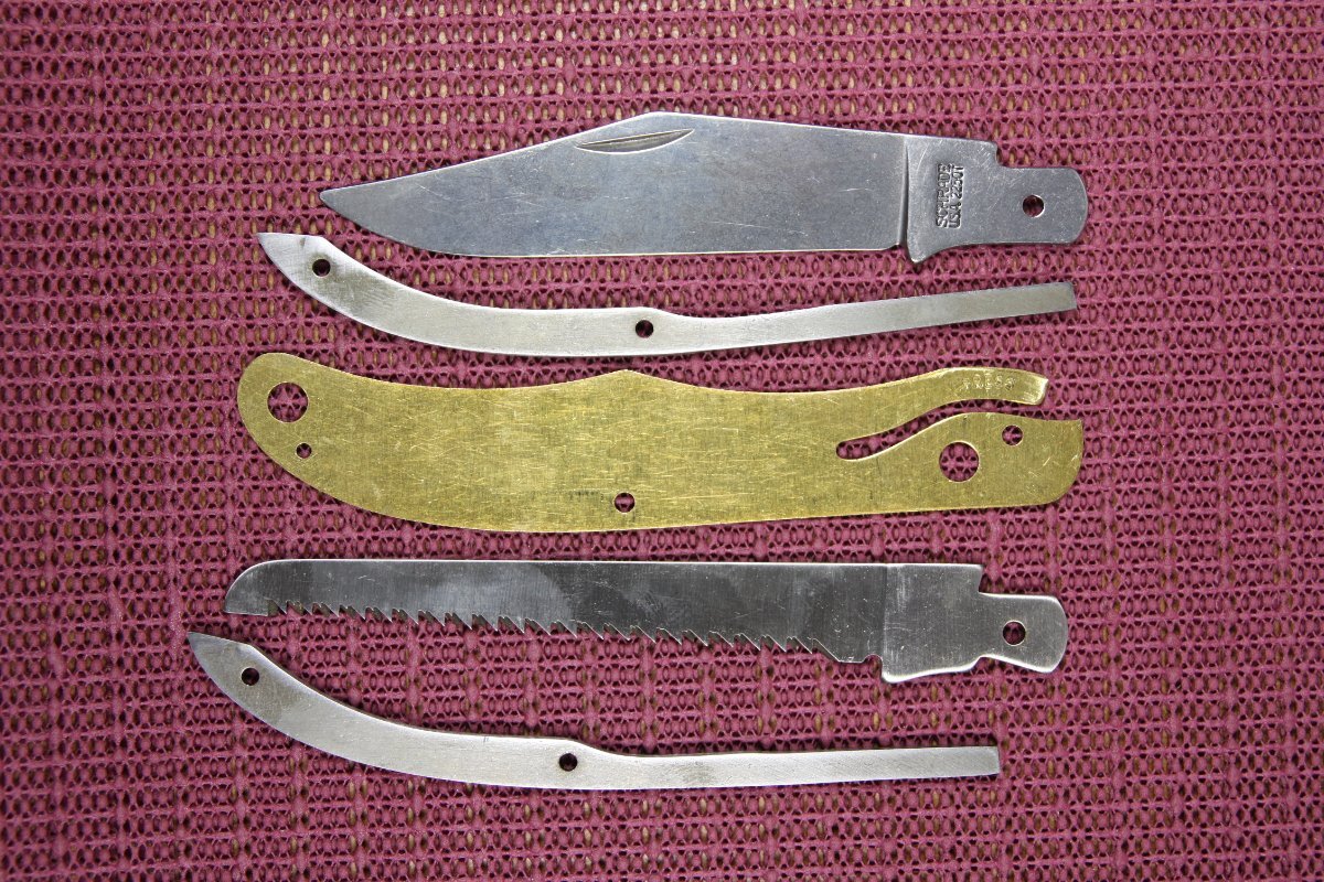

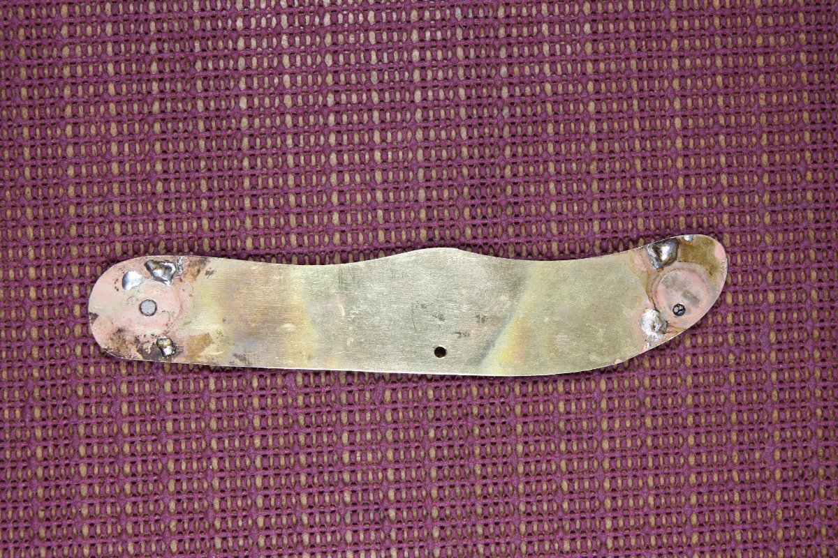

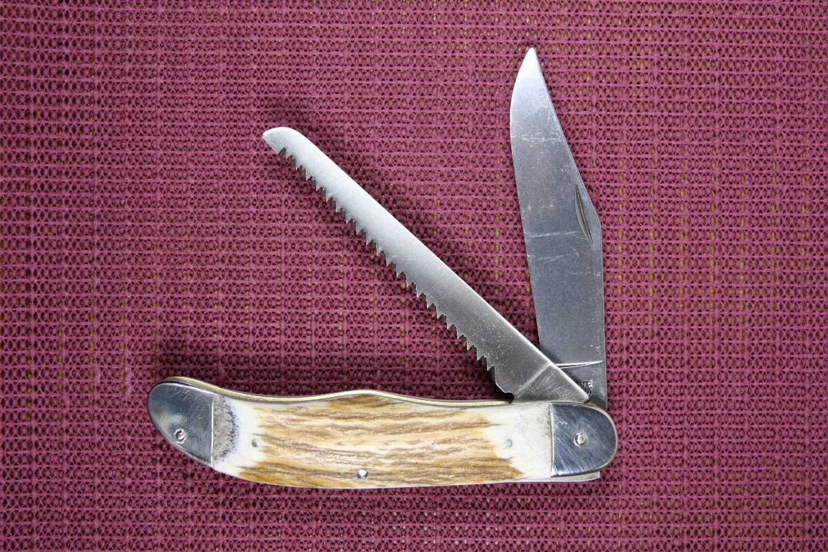

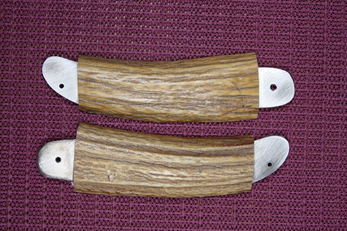

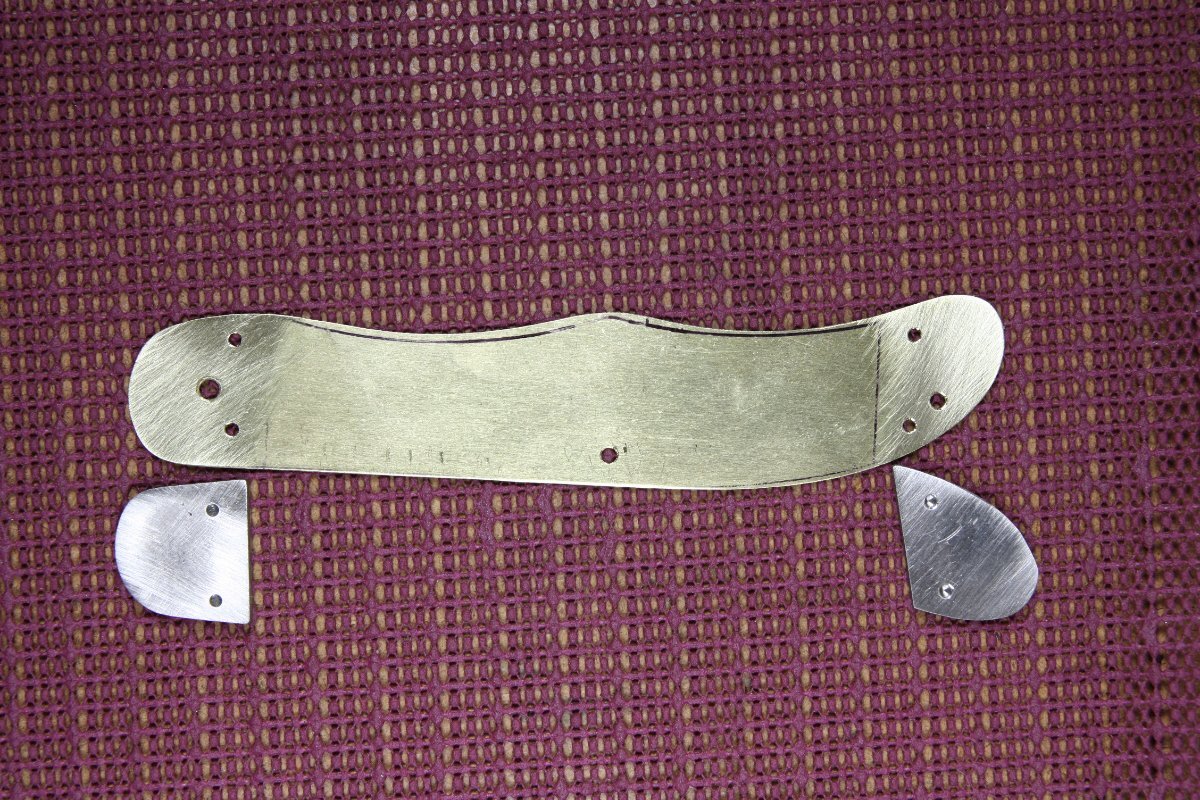

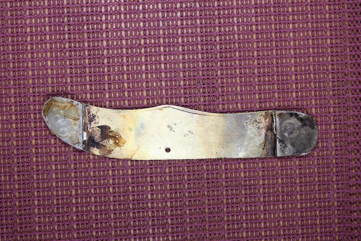

Another project I mentioned above, the 225 OT. The list of Schrade parts used is the master clip blade and saw blade, both springs, and the center divider/liner lock. The parts I made included .032" brass liners, 4 bolsters, and stag handles. Not an authentic factory 225 OT, but will be a fine user. I have marked it inside the liner with the word "parts", my mark, and date. The piece of stag was split with a hand saw to take advantage of the curve and it almost looks book matched. It's a bit thicker to give a better grip for using the saw blade which cuts on the pull stroke. Note dome headed pins.
Schrade parts used
Liners and bolsters made
bolsters soldered
Stag attached
Finished product

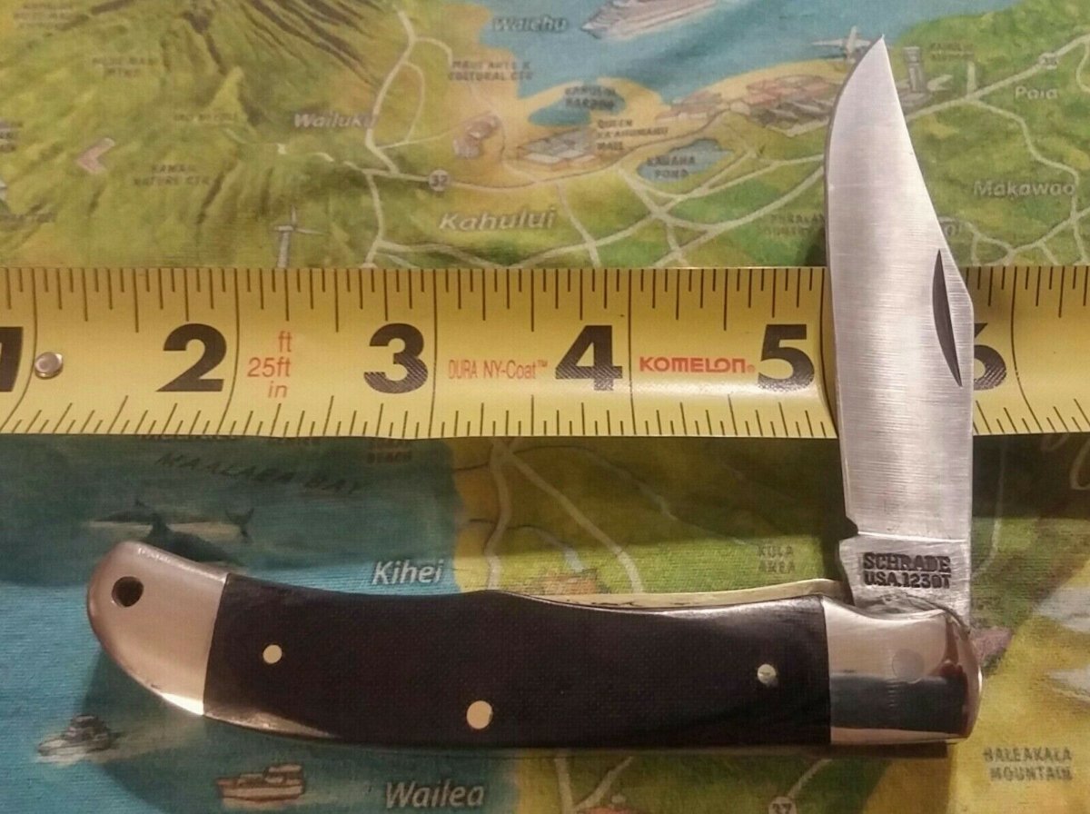

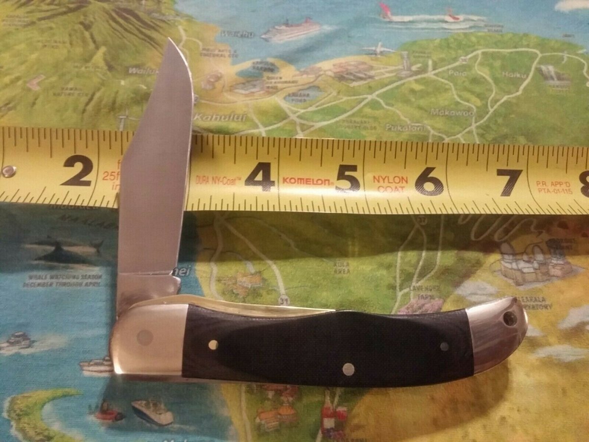

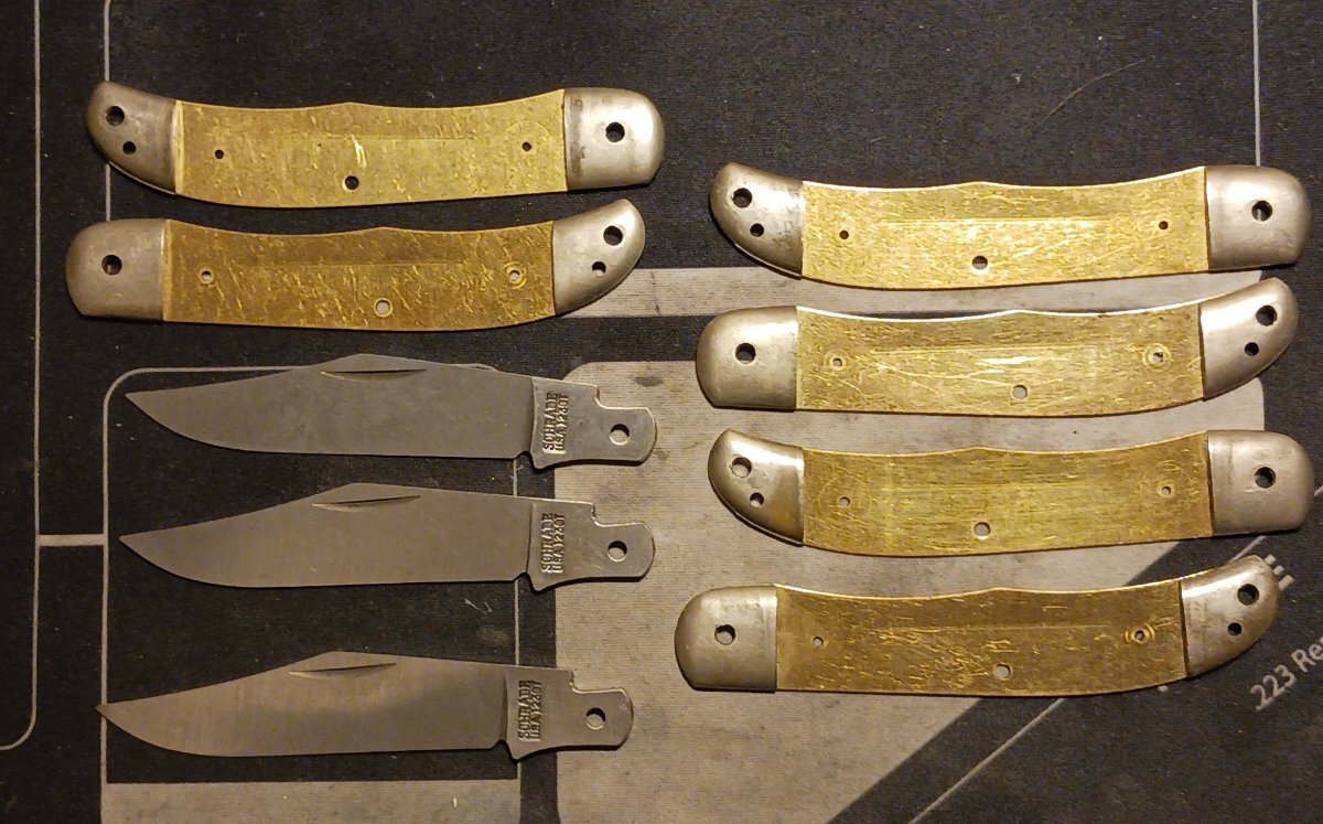

Cal, thanks for showing the 123 OT. I have 3 of them to work on next. As seen in the photo, these 3 are not Swinden pinned. I will make 3 different handle materials, and have to make 3 springs. If you look closely at the finished picture of the 225 OT above, you can probably see the mistake I made that makes the saw less than ideal to use. I am probably going to have to disassemble it and fix it.

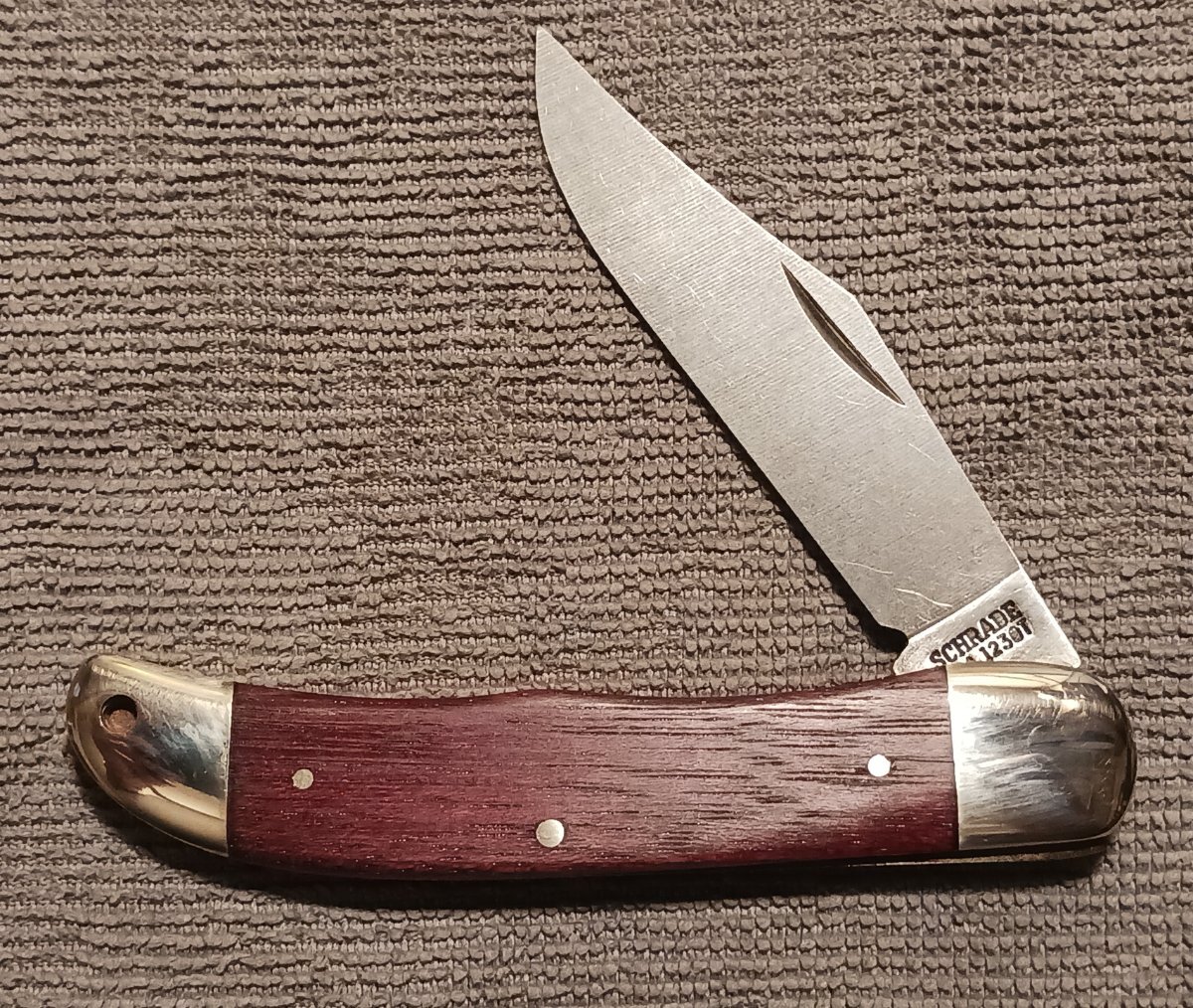

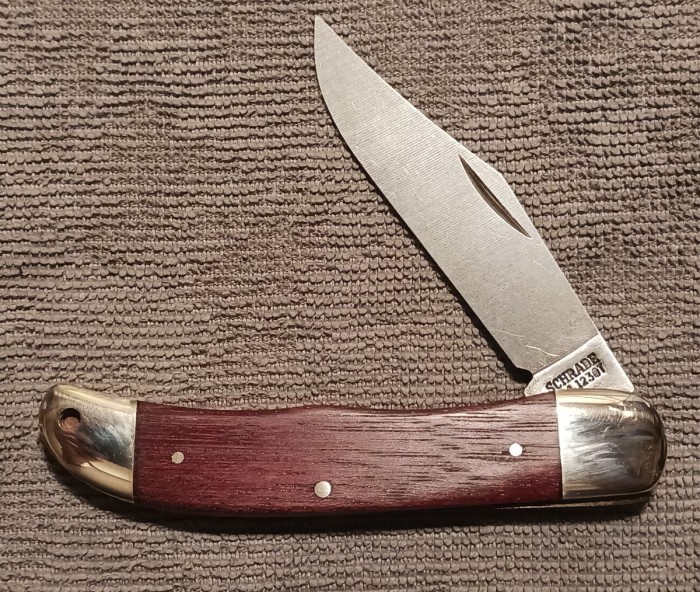

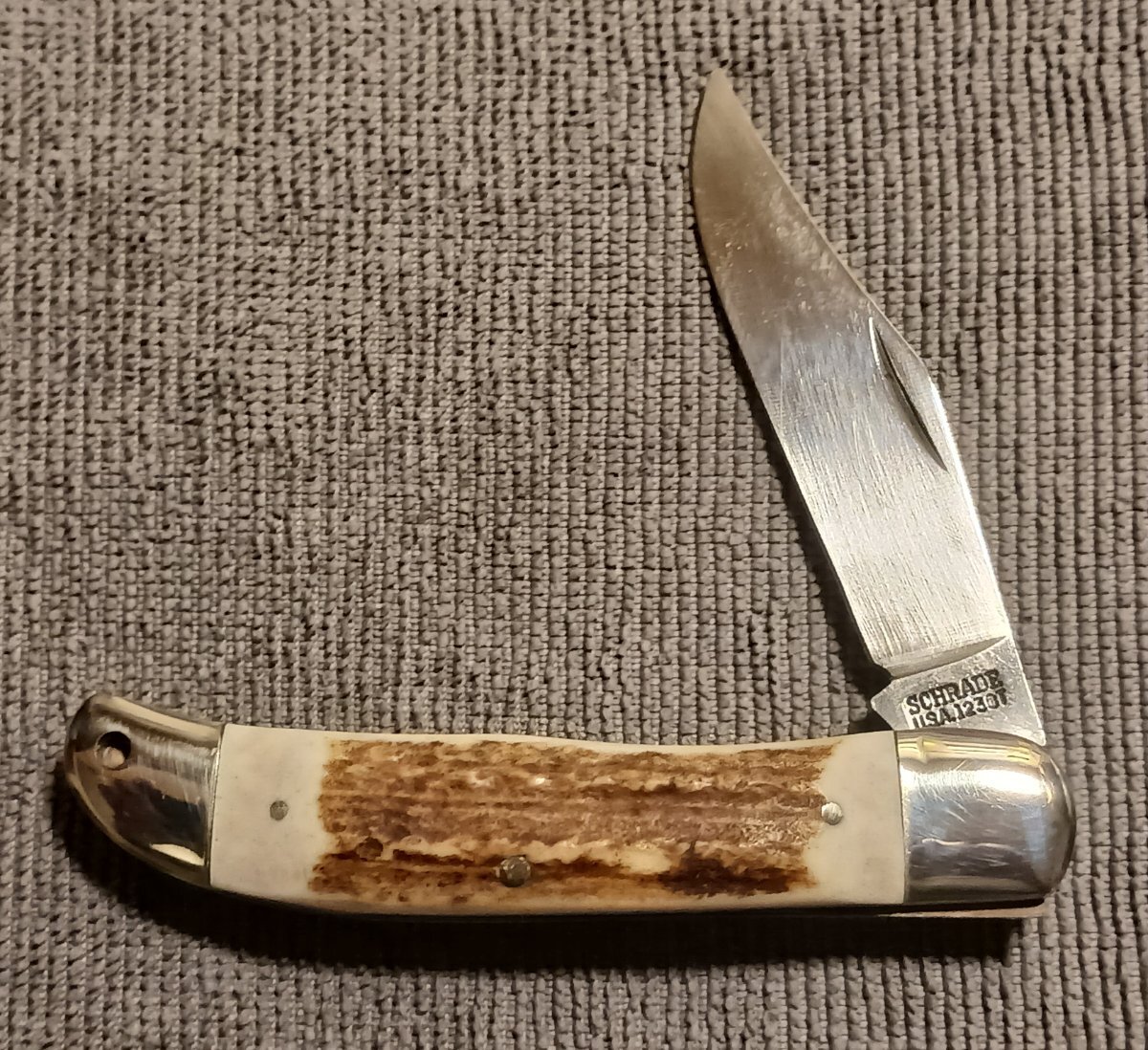

I finished one of the Schrade 123 OT knives. I had the blade, liners with bolsters attached and made the spring and bloodwood handles. First one of these 4 inch Old Timers I have had.
tongueriver
Posts: 7250
Re: Schrade parts knives
Post by tongueriver »
::tu::
Posts: 24147
OLDE CUTLER wrote: Fri Aug 21, 2026 6:01 pm I finished one of the Schrade 123 OT knives. I had the blade, liners with bolsters attached and made the spring and bloodwood handles. First one of these 4 inch Old Timers I have had.
That's a hand full OC! Great work.

Another 123OT in stag.
tongueriver
Posts: 7250
Nicely done to a great pattern!

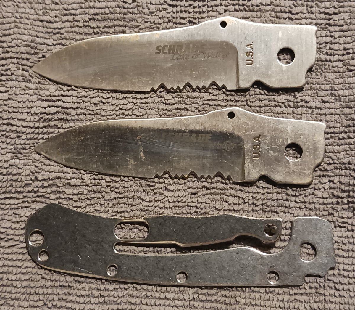

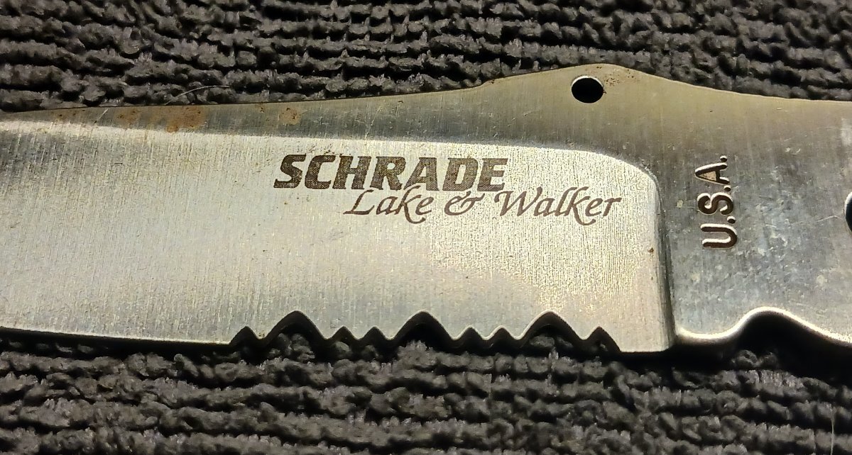

Thanks Cal. I discovered that I have some parts for a Lake & Walker lockblade. I have never actually seen one. Do you have one?
tongueriver
Posts: 7250
Those were available 3 different ways. The original run was quite limited and serialized. It was in BG-42 steel and the blade was not serrated. The first 100 were part of a plastic display with an Alton D'Holder Schrade collaboration fixed blade in stag. I had one of these and sold it. The rest of them were seeded into the market. A bit later another run came out in ordinary stainless steel and with the serrated blade. I have never had one. I don't have any version of them anymore. There are flyers for these knives on Larry Vickery's website. I found the one flyer for year 2000 (I think) but I must have missed the earlier ones.
